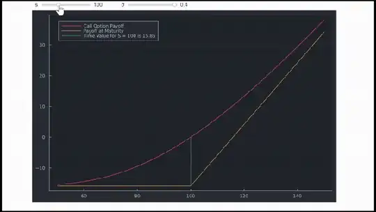

ATM has the largest Time Value. Therefore, increasing strike results in an increase in time value for ITM options because we move closer to ATM. The opposite holds for OTM options where S < K. Below is a GIF showing this relationship and how TV is changing.
