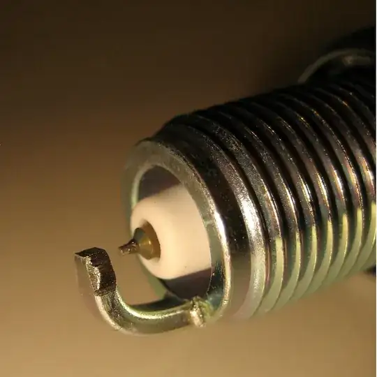

If a spark plug fails to "spark", it can often be fixed by cleaning its active side.
The spark of a spark plug (Image from https://commons.wikimedia.org/wiki/File:Bougie3.jpg, CC-BY)
On used spark plugs, the part where the spark is generated is often dirty and covered in carbon black. Clean that away. The above image shows how it should look like. The spark is generated between that thorn in the center and the metal bow.
Additionally, the distance between the two electrodes must be within a certain range, typically around 0.5-0.8mm (the exact range should be in the engine manual). If the distance is way bigger than that, it won't work correctly. This can be fixed with a few careful hits with a hammer on the bottom piece.
