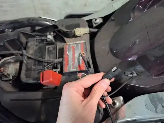

I've reinstalled a battery in a bike that was sitting in storage. After installing the battery, the bike won't start. The fuel injection thing does not display its power light indicator.
There was this loose cable under the seat. I don't see any logical place where this would connect to anywhere on the bike near the battery terminal. (The cable in my hand)
Does anyone know what this cable is for, or where it goes? For reference, this is a Suzuki Boulevard C50T. Thanks a lotwhere does this cable go

This appears to be a connector for a battery maintainer. It allows you to leave the plug on the bike permanently so you can connect and disconnect the maintainer from the bike without having to fool with tools.
Example from walmart.com (no endorsement implied):
