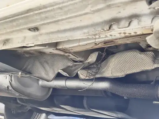

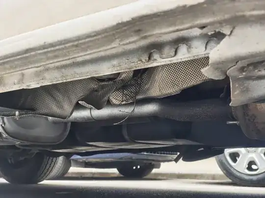

I went to view a 2012 VW Transporter T5 and noticed that the left underside heat shield was damaged. It looks like some shrubbery has lodged itself in there too.
Is this a serious thing or relatively minor? Can it be manually twisted back into its rough original shape?

It probably won't hurt anything if it isn't "fixed", but realistically you could fairly easily get it back into shape by just using your hands (I'd wear gloves to prevent any abrasion, though). The heat shields are usually made out of fairly thin, flexible, malleable metal ... this is the reason why it's bent up in the first place. It doesn't take much to get it bent, but on the other hand it doesn't take much to get it sort of back into shape. You'll never make it look like it was when new, but if you're not worried about it, it will just be kinda crinkly and underneath the vehicle. The big thing you need to know is, in order for it to work correctly you need air gap on both sides of the heat shield. As long as you have that, it will function just fine.

Worried, no. Fix it, yes.
Paulster2 explained how to do the fix, I am explaining what you will get if you don't.
  1. Fire risk. In hot enough weather, dry grass, wood, plastic or paper pieces touching the exhaust system can ignite when the engine is ran near its top performance for a while and the pipes get hot.
  2. Reduced comfort. Again related to hot weather, a hot spot on the floor can be a major discomfort source for someone sitting over it (or damage some heat-sensitive payload, e.g. chocolade).
  3. Heat damage to the coating of the metal elements around, promoting corrosion in the future.
