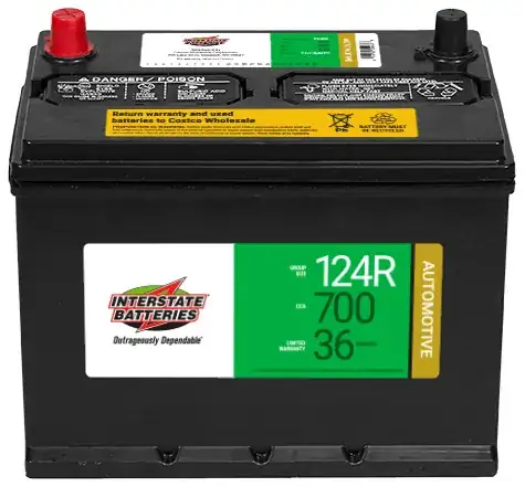

I want to use the force charge mode on my Noco Genius 1 and I'm supposed to select the battery type. Options are:
  1. 12V = 12-volt Wet Cell, Gel Cell, Enhanced Flooded, Maintenance-Free and Calcium batteries
  2. 12V AGM = 12-volt AGM batteries
  3. 12V Lithium = 12-volt lithium-ion batteries, including lithium iron phosphate
  4. 6V = 6-volt Wet Cell, Gel Cell, Enhanced Flooded, Maintenance-Free and Calcium batteries
My car has this interstate 124R battery I bought a few years ago from Costo. batter picture
Besides knowing it's a 12V battery, I don't see anywhere that says what type of battery this is. The description on Costco's website reads:
  • Group Size: 124R
  • CCA: 700
  • CA: 875
  • Voltage: 12
  • Ah: 58
  • Termination Code: TOP
  • Wet/Dry: W
I want to be sure I use the right mode. What type of battery is this so I can select the right option?
sushi
  • 283
11
That is a standard wet cell, 12V lead acid battery, the default mode on the charger is correct.

No recent car has 6V, so you can skip that. You can also skip 12V lithium (which means only lithium iron phosphate as there is no other lithium-based chemistry that offers 12V voltage). The reasons being many why they are not used as starter batteries. Theoretically, a car that has 48V starter system (integrated starter-generator) could use lithium iron phosphate for the 12V battery.
Gel cells, by the way, are not used for cars.
So that leaves 12V and 12V AGM. The correct algorithm for determining if you have AGM is: look at the word "AGM" printed somewhere on your battery label. If you can't find it, it's not AGM.
I can't see AGM printed on your battery label, so the 12V option is the correct one.

All lead-acids car batteries are heavy. Lead is notorious in this regard. The battery pictured above is ~20kg / 45lbs.
If no bragging labels say "AGM", it is flooded. When gently shaked it makes splashy noises.
AGMs wear bright labels saying "AGM". They are completely silent when shaked.
Gels are not used in cars, but can be found in UPS devices, house alarm systems and big powered toys. If you find a battery in a place like this, it is gel.
Lithium-whatever batteries are lightweigth, Li is the lightest metal. A battery with the same size like the one in the question will be 4-7kg. It will also have a big shiny label saying it is Lithium-something.
Lithium batteries of comparable capacity are still expensive compared to AGM. Li batteries of comparable SIZE are even more expensive (and more powerful as well).
