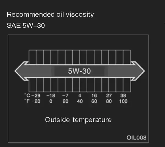

The Toyota Prius 2007 Owner Manual states that the recommended oil viscosity is SAE 5W-30 when the outside temperatures is between -18°C and +27°C:
What's the recommended oil viscosity when the outside temperature is higher than 27°C? The summer weather at my location gets pretty warm.
