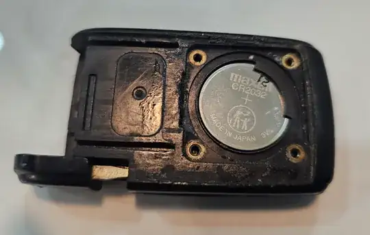

I've just changed the key fob battery (CR2032) but the warning is still present:
