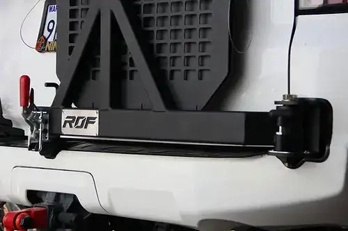

  • What paint would possibly achieve the second photo? Satin Black? Mattee Black? I called the manufacturer of the shop and they mentioned "It's powder coat every off-road shop uses", I need to mimic and see if I can get a similar result with paint (Except the textured part).

This is the goal, using paint.
Manufacturer Swing-Out with Powder Coating
