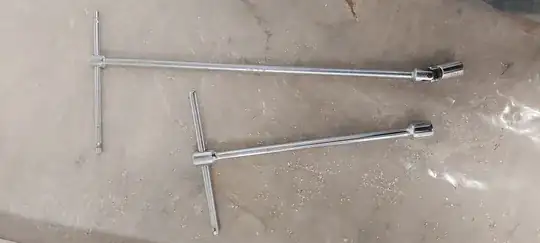

That's the reason why I prefer sliding T-handle wrenches.
sliding t handle wrenches, swiveled and fixed
The sliding handle allows both strong turning and quick spinning.

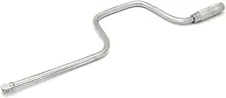

Manual or electric speed wrenches in many price ranges. manual speed wrench
rechargeable speed wrench

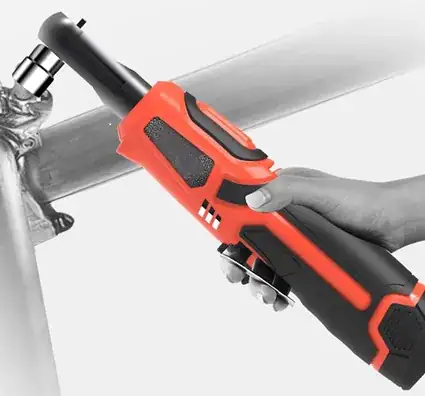

A friend said this:
I’ve used a battery ratchet in that case, faster and enough torque to remove the bolt.
Also, a stubby impact has done an excellent job for me as well.
If you can put some back pressure on the bolt head to stop it from turning while you loosen it, that would make it easier for you.

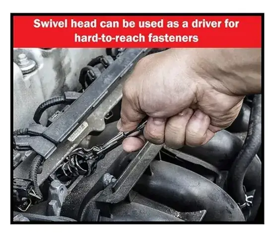

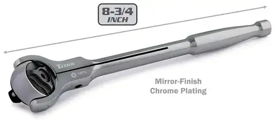

For cases where there's not enough space for a T-handle, a swivel-head ratchet could be an option. When the handle is perpendicular to the ratchet head, the handle can be spun in one's fingers.
Titan 11076 3/8-Inch Dr Swivel Head Ratchet
