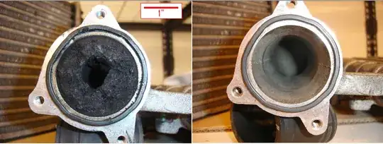

Here is a photo that I took of my 1.9L VW TDI diesel after going too long without cleaning the intake runner and manifold. Before cleaning on the left, after cleaning on the right.
This is the intake runner just beyond the EGR valve and before the intake manifold. Even with this massive blockage, there was only a slight loss of power, no smoke, no difficulty starting and better than normal fuel consumption. No engine codes. The engine management system compensated for the restricted airflow by reducing fuel usage, which reduced engine power a little. It was most noticeable when accelerating on the highway, but not noticeable at all in city driving.
If the Vauxhall zafira diesel 1.7 has a similar engine management system, I would expect the same effect as the VW.
