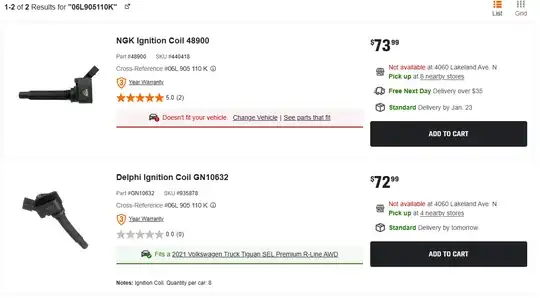

However, when going to the AutoZone website for the 06K905601K spark plugs it returns two models that the site says do not match my 2021 VW Tigaun SEL (added to AutoZone by VIN).
Also, when searching for the 06L905110K Coils it returns two products, one of which does fit the 2021 Tiguan SEL and the other does not.
Can you please help identify which Spark Plugs and Coils are the correct ones to order?

My sources show the following for your Tiguan:
Spark Plugs:
  • BOSCH 8501 EVO
  • NGK 95749 Laser Iridium
Coils:
  • DELPHI GN10632
  • SKP SKUF716
  • BECK/ARNLEY 1788607
  • STANDARD MOTOR PRODUCTS UF896
  • WVE 5C2280
All the coils shown are specifically listed as a replacement for the 06L905110K.
