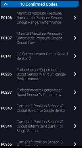

I recently purchased a 2015 Fusion that had a P0141 O2 sensor error, car ran fine. Then, my daughter was driving it and it went into limp mode. Hooking it up to my code reader, this is what I saw :
Codes1
Cleared the codes and got it home. Then ran fine.
