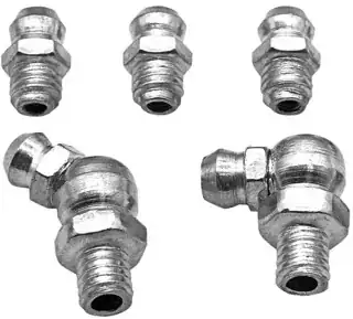

When I searched for generic spare parts I found not only "normal" fittings but also 45° and 90° angled, such as these (image from the cheap-and-cheerful Swedish store Jula):
Photo of grease fittings with three different angles
My question may seem trivial but I wonder if I can simply replace the straight hard-to-reach grease fitting with an angled version with no side effects?
They seem mechanically more complex so maybe they are prone to failure? On the other hand it seems like these grease fittings are designed to be replaced so it's probably not critical.

Yes. There's no problem to replace the grease nipples with an angled one, or even a different type.
The important parameter is the threads that enter the part. Common threads are BSF, NPT and metric threads. Within each of those there's different dimensions. You'll have to figure out which thread type and size is appropriate.
