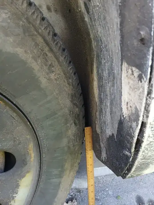

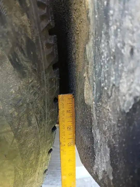

From a quick glance, there doesn't seem to be much room between the front tire and the fender wall. This ruler is 7/8 of an inch wide, and it only fits if squished between the tire and the fender wall. So the gap is a bit smaller.
Front left:

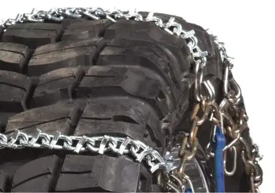

So I would be worried the chain would hit the fender wall, especially with chains that have V-bars like these:
Light Truck Lightweight Canadian Spec V-Bar Tire Chain
