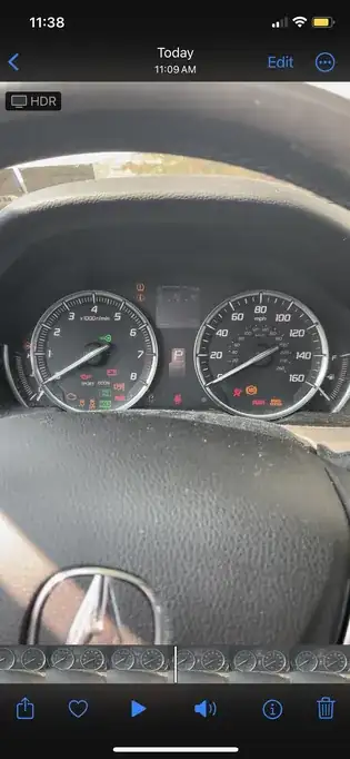

My 2016 Acura TLX won’t start, even after being hooked up (properly) to jumper cables and waiting for 15 minutes. Battery is less than 1 year old.
Attempting to start it gives rapid clicking noise, flashing lights, a rising fuel gauge. Once this gauge hits the max, it comes back down to 0, clicking stops, and all warning lights flash briefly (see screenshot). The AC then turns on and the car displays that I am in park. Engine has not turned on though.
Any idea what is causing this? The battery is essentially new. Must be an ECU problem right?
Dash after failed start

If your voltage measurement is valid at 1.2 volts, then your essentially new battery is essentially dead.
(I'm only questioning the validity of your measurement because if you are not familiar with voltage measurements and your meter is not auto-ranging, 12 volts can be mistaken for 1.2 volts. For the purpose of this answer, I'll assume that the reading is accurate.)
To take this any further on your own, you need to (1) fully charge the battery and (2) test the battery or have the battery tested.
