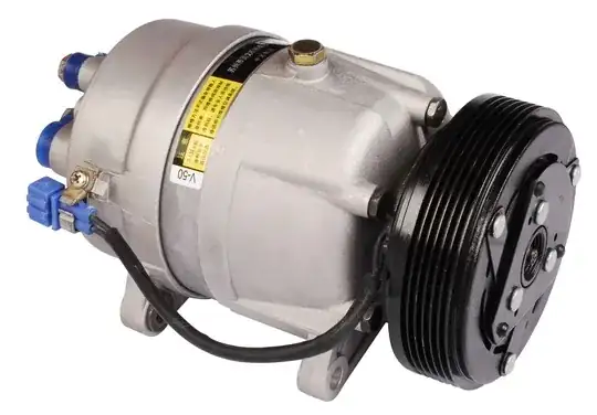

If the system is either working fine or not at all then the likely failure is in the control gear for the system, the AC clutch would be my first port of call, you'll need an assistant:
Open the engine bay and look for the AC compressor, it is one of the ancillaries at the side of the engine run by a serpentine belts. The compressor pulley has a clutch built in, so that the pulley always spins, but it only drives the compressor when the AC is switched on (activating the clutch).
AC Clutch
You can see if the clutch is working by:
  1. Locating the AC compressor
  2. Starting the engine, with the AC off
  3. Observe that the middle of the pulley is stationary, this means that the clutch is not engaged
  4. Get your assistant to turn the AC on, you should hear a click and observe that the middle of the pulley is now spinning
If it does not spin then you've either got an electrical fault or the clutch has failed. If the middle of the pulley is not spinning you can try to get a multimeter on the electrical connector and read the voltage when the system is turned on
  • If there is 0v you have an electrical fault
  • If there is ~12-15v the clutch has failed and the compressor should be replaced
