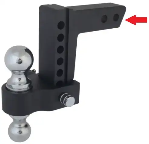

I've noticed that some trailer hitch ball mounts are angled at the rear of the shank.
https://www.cabelas.com/shop/en/trailer-valet-blackout-series-10000-adjustable-drop-hitch
What is the purpose of that angle? Does it solve a problem for the user, or is it a manufacturing quirk, such as using less steel?

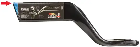

This hitch has a sticker on it that says "Easy Load Angle".
https://www.canadiantire.ca/en/pdp/reese-towpower-carbon-forged-ball-mount-2-x-4-in-drop-0403017p.html?rq=reese+towpower+carbon+forged+ball+mount#srp
My guess is the pointed part is easier to fit in the hitch receiver than a square tube.
