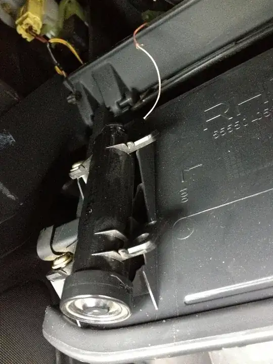

While fully opening the glove box on my Avensis '02 (to get behind it for a job) I broke something. I did a bit of research and I can't be sure but it might be the glove compartment damper, which if it is I assume is not that important (to me anyway). I don't know for sure though. I was hoping if I described it maybe someone would confirm.
It's cylindrical and about the size of a fat pen and is screwed to the back of the glove box and then attached to the chassis with something like a string ... this string was very short and broke when the glove box opened fully.
Does anyone know for sure?
Also, if it's only to dampen the glove box (using weighting I'm assuming) then what is the purpose of the string?
Here's a photo ... you can see the broken "string" in the background. PS although it looks in the photo like it's connected to the hinge it isn't actually touching it at all.

Going purely on the fact that it's a Toyota and that part looks very similar to one in the glove box of my Prius, yes, it's the damper. And I can confirm that the damper includes a spring, a couple of small wheels, and string.
The only downside to not replacing it is that opening the glove box becomes a fairly rough experience. I finally bought one when I noticed that the frame around the opening was getting fatigue marks on it.
