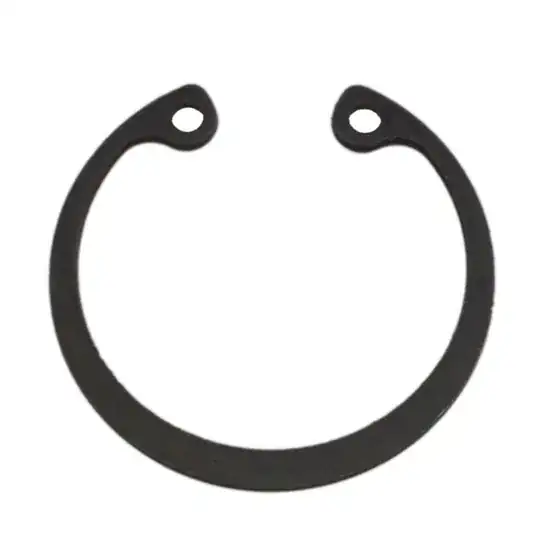

U-joints that are designed to be easily replaced have some kid of internal circlip holding the u-joint caps in place.

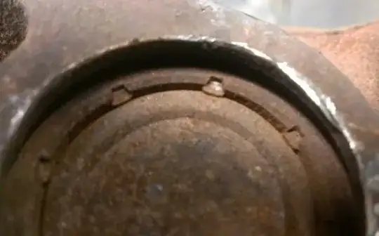

A staked u-joint has some of the metal of the joint peened over to hold the caps in place like in this photo - enter image description here
It is still possible to replace these u-joints. If you search on YouTube for staked ujoint you will find examples of mechanics doing this.
