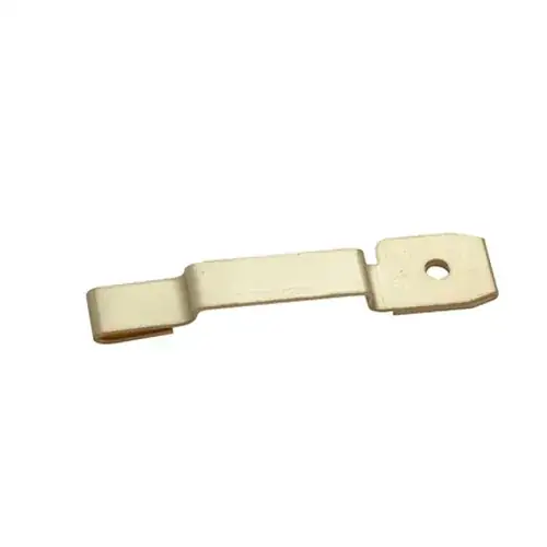

You can draw power from the fuse box by using a blade which looks something like this:

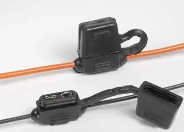

This adapter fits on the blade of an existing fuse. The left side is the part that the fuse fits into. The right side of this is used as a blade for the connection. The only thing you need to remember is this adapter needs to go on the POWER side of the fuse, so you are not using the fuse for the link, and then put an inline fuse before the power gets to your device. An inline fuse can look like this, but there are many variations:
