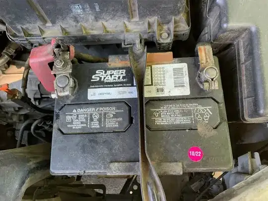

It's my understanding that driving on a bad battery is what causes the alternator to burn out. So, if not the battery itself than what other reasons could have caused the battery drain in the first place? The only thing that comes to my mind is a bad connection to the battery itself but I don't know what good connection looks like to compare to what the wires in my car look like. I'm attaching a picture so see if this looks bad to a person whose seen under the hood of more cars than I have. The connection to the positive end of the battery looks pretty frayed to me, but enough to cause these issues?

More than likely the alternator just went bad. When it did, it quit charging the battery. The battery lasted as long as it could until the vehicle systems ran the voltage down. I don't think there is anything else you need to follow up on. Make sure that the clamps at the battery are clean and tight. Check to ensure there is ~13.5-14.1vdc at the battery when the vehicle is running. As long as these check out, I doubt you have much to worry about.

It's possible that a bad battery There are a couple of ways your alternator could break:
  1. The electrical components could fail: the stator coil, rectifier or regulator could burn out and the alternator stops charging. The more demand on the system the harder these components have to work, in theory a bad battery can over time put such a high sustained demand on the alternator that it causes one of these components to fail. So it's possible your battery was bad and burned out your alternator, it's more likely that corrosion and plain old wear and tear would be the culprit
  2. Bearing failure: the alternator is driven, i.e. spun by the engine, connected by a belt. When your engine is running your alternator is spinning, whatever the demand. Over time the bearing on your alternator will wear and eventually fail, and the alternator stops spinning. Bearing failure has nothing to do with the demand on the alternator
Alternator failure is very common and it's almost always because of wear and corrosion rather than being induced by excessive load. If this is your car's original alternator you've done all right, I wouldn't worry about it.
