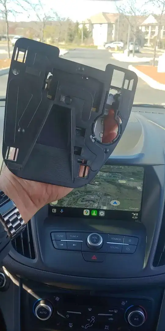

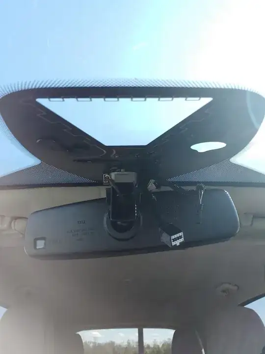

enter image description hereenter image description hereMy daughter just bought a 2019 Ford Escape SE 1.4 turbo. 47,000 mi. Upon inspecting the faulty rain sense sensor, I noticed that the previous owner improperly installed the plastic housing that contains this sensor and the front camera. The housing was separated from the windshield by about 1\2" on one side by dried glue. I was able to remove the plastic housing. What I would like to know is the proper type of glue to use to reattach. The side that attaches to the window has nubs that keep the housing about 1\16th" off the window, so a liquid glue will not work. It will need heavy duty 2 sided pads or some glue with a thick consistency. Does anyone know the proper product to use?

Not knowing what was used in by the OEM, there is rearview mirror adhesive. Personally, I think something which is an epoxy would work best. I read on the internet people have also had good luck with cyanoacrylate adhesives (otherwise known as "Superglue").

It may be a learning experience, but I went with the 2 sided tape. She's not a paying customer, so it really doesn't hurt to experiment. If it doesn't hold I'll do something different. Worst case scenario is it falls off. One other unfortunate thing is that I don't think I got it positioned perfectly. I don't think it will affect the lane assist though, but if it does I will do it again after I know it holds. I also confirmed that the rain assist sensor is bad.
