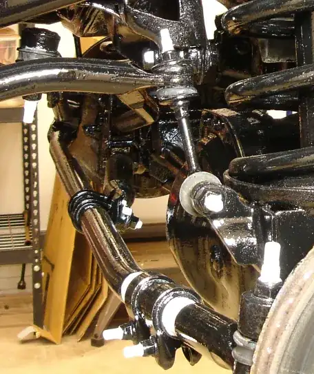

After I de-rusted and repainted the undercarriage on my truck, I wanted to protect the exposed threads on various fasteners. Painting them was not an option, as that would make disassembly much too difficult.
So I used a product called Liquid Electrical Tape (available at home improvement stores) to protect the threads. I brushed on a coat of the white version, let it dry, then added a second coat. In the event that one needs to disassemble the fastener, all one has to do is rub it off with a wire brush.
It has been six years now and the coating is still intact. A few spots have turned a bit brown from rust, but I can say with certainty that the threads are still intact and serviceable.
