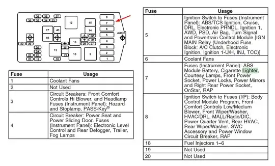

Looks like this is the location of the relevant fuse in the 2004 Venture from the manual:
