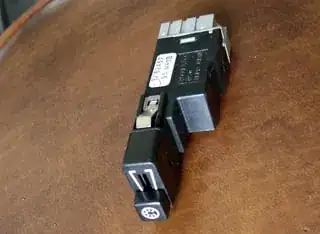

It's probably the dimmer. To the left of the instrument cluster, next to the driver's side air vent, is a light dimmer slider. When they get old, they get finicky and the car thinks you have the dimmer set to "0" when they malfunction, so it thinks you want to turn off all the instrument lights.
The problem is the slider mechanism which is these 3 tiny prongs which are supposed to ride along a metal strip and they have a very gentle spring which is supposed to hold them against the strip. It is very difficult to repair this mechanism.
What I did is just remove it from the dash, stuff some paper towel in there to force the prongs against the contact in the max position.
Alternatively, you can replace the whole thing by buying one off eBay:
Volvo 850 dimmer
