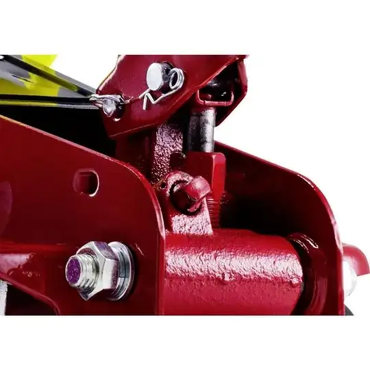

In the image below from an online shop, the valve which determines lifting and release is a simple screw. The shape of the screw matches a distorted handle end that becomes part of the lever used to pump the hydraulics.
lower cost floor jack detail

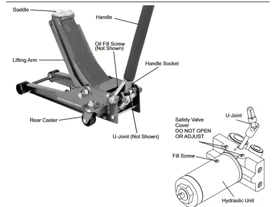

In the image below, taken from a Harbor Freight floor jack manual, one can see a reference to a U-joint, which is connected to the pump handle, but does not require that the handle be separated and moved to a valve screw.
HF floor jack with integrated valve
