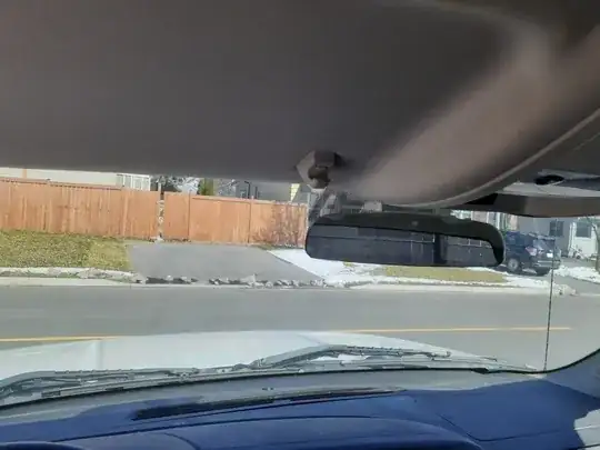

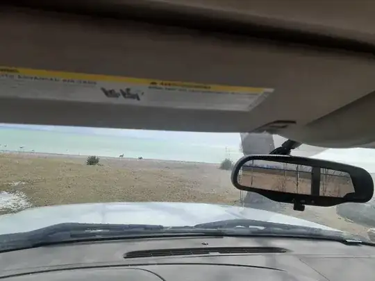

I'm big & tall. This is what I see out of the windshield of my truck:
The rearview mirror blocks the center-right portion of the window. I've had a couple close calls where I didn't see something that was obstructed by the mirror.
Additionally, I can't see upwards well enough. If I'm sitting at traffic lights, I can't see the lights without slouching.
I'm new to driving a truck. What am I missing? Is this a common problem?
The seat is slid back all the way (I don't want to be right up against the steering wheel/airbag) and the back of the seat is tilted forward all the way (because I like to sit upright for back health). It doesn't seem to be possible to lower the seat. All manual controls.

I did a few small things that made visibility good enough.
  1. As @TigerGuy mentioned, I fully adjusted the rearview mirror upwards. I didn't realize it, but the second ball joint was seized, so I didn't realize it could be moved further upwards.
    Reddit - Rearview Mirror Limits Sight
  2. The mirror still blocked my view more than I liked. So I removed its bulky plastic trim, including the OnStar buttons (not functional), from the mirror. Now, the footprint of the mirror is smaller.
    I can reinstall the adjustor tab if I need to. The bracket is still there on the rear of the mirror. But now that the trim is removed, the adjuster tab isn't really needed since the mirror can just be tilted up by hand, which tilts the same mechanism that the tab would have tilted (not the ball joints, a different pivot mechanism).
  3. I also removed the driver's side sun visor since it blocked my view of traffic lights, even when in the up position; the visor sat proud of the roof, effectively making the roof 1 inch lower.
    I don't use the sun visor since I sit so high. And I'm the only driver. So removing it isn't really a problem. Even still, I kept the visor in the truck, along with all the parts and required tools, in case a different driver needs to reinstall it.
