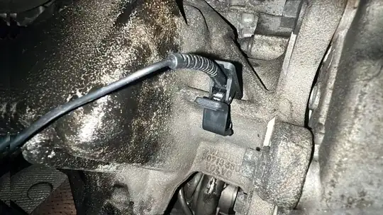

I haven't fully identified the source of the sound but I set a few microphones around where I suspect the sound is coming from. This first recording is focused on the transfer case aka bevel gear. One of the microphones (the contact mic) is clipped on to a rib beneath the transfer case like you see in the photo below, the other (a lavalier mic) is taped to a cross frame member facing up to the same transfer case (which as you can see is leaking some old greasy dehydrated oil and gunk).
contact mic attached to transfer case
I'll be checking the bevel gear oil level soon and maybe drain and fill it and also take a few more recordings to zero in on the sound by studying which mic pics up the loudest. As always any help folks can offer will be greatly appreciated!
