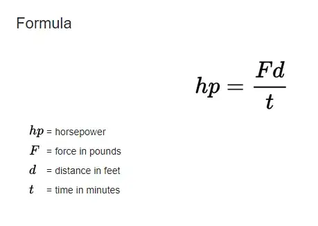

The first way is to allow the engine to rev higher. Given that horsepower in and of itself is just mathematically derived from torque at any given engine speed (work over time), all you have to do is allow and engine to spin higher and it can produce more horsepower. Here's the formula:
There is a point where the friction produced inside of the engine will limit the amount of power which can be produced.
