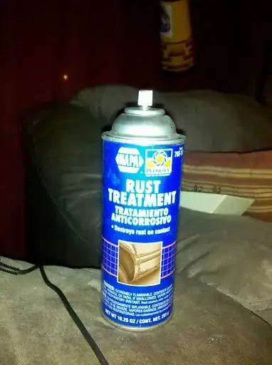

Napa Rust Treatment Permatex 765-1671
I used Napa Rust Treatment Permatex 765-1671 on my F-150 truck about 8 months ago and all the rust is gone! This treatment is like a grey primer. It's not pretty on a blue truck, but neither is oxidized red cancer.
