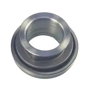

  1. I believe it would be pretty hard to get the throw out bearing in backwards. Flat side towards the clutch, right? it may be the case, but I find it highly unlikely. (See the picture below) What you see is the side which goes towards the transmission. NOTE: This type of throwout bearing is supposed to be self aligning ... that is the reason for the pointy part. In practice it doesn't work that well, but at any rate, the pointy part should be away from the clutch fork.

Throw out bearing for Bronco II
