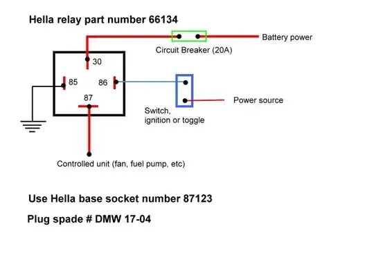

If the clutch proves out to be good, the next thing you can check is to see if the relay itself is bad. Change this out with another relay in the same fuse panel as they are standard. As long as they are the same shape, they should be exactly the same. You can also apply power to the subject (12v) relay while checking continuity. You can use this diagram to see how the relay lines up (if not exactly the same, it should look something like this):
Relay Diagram
