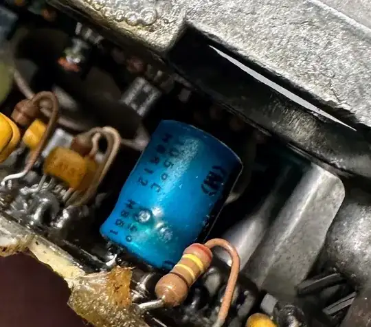

My 1986 truck is running rough and has fault codes that come and go. I think the electronic engine control module may be the culprit. I removed it and one of the capacitors has odd markings on the side. See picture below. It does not have a bulging top and I don't see fluid leaking. All of the other capacitors look fine.
Is it likely that this capacitor is faulty? More generally, would it make sense to replace all the capacitors since they are almost 40 years old? The truck runs fine in general, but has fault codes and rough idle that come and go. I've checked everything else I can think of. I don't really want to mess with the EEC module unless there is a good chance that the capacitors are indeed faulty.

image of capacitor

The one in your image seems to have some burn marks so I'd be suspicious about it.

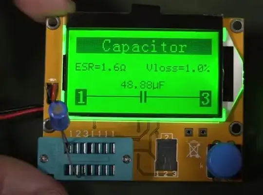

Get yourself an LCR component tester for about €$£10. This will allow you to remove each capacitor, check its capacitance and its equivalent series resistance (ESR) which can deteriorate with age.
Figure 1. Screengrab from LCR tester review on EEVblog video.
You might as well replace them all while they're out but using the meter might help confirm that there was an actual component problem. You could also compare the ESR of each old and replacement component.

Is this capacitor faulty?
You won't know until you pull it out and measure it using an ESR or RLC meter (not a multimeter).

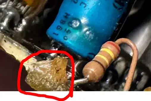

It appears to me that hot wax or flux or similar has dripped onto the capacitor melting the plastic wrap over the aluminum can. There is some waxy looking material protruding over the capacitor (red circle). I doubt that this would render the capacitor defective. That does not rule out that it is faulty. Replacing all the electrolytics (testing as you go} as suggested in other amplifiers is a good idea.
