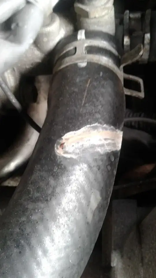

I had a very minor pin hole on the upper radiator hose.enter image description here
