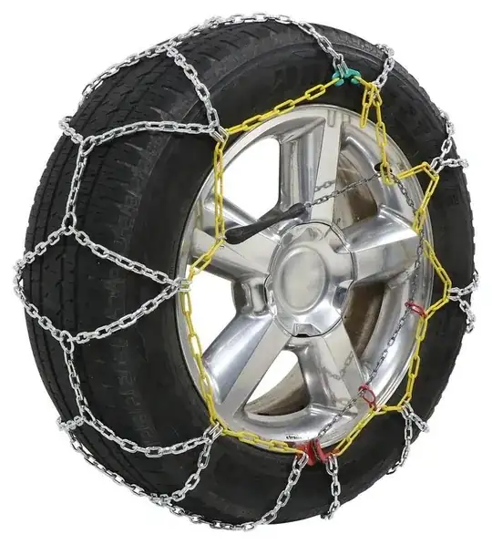

Dealing with diamond pattern tire chains of this type: https://www.canadiantire.ca/en/pdp/passenger-diamond-back-square-link-chain-0301240p.0301234.html?colorCode=MANUFACTURER_PART_NUM_1555Q#nl-product-details
The ones where you have these plastic tubes that you connect behind the tire.
My tires from the 2019 Honda Odyssey Touring are 235/55R19, which is listed on the package of the tire chains I got.
But after doing the first step of linking the "tubes" behind the wheel, and linking the "yellow" chains at the front, I cannot possibly get the red chain through the cam...
Am I missing some gotchas, or could it be that the chains are too small even if my size is listed?
Providing visual reference for what I'm talking about:
In this picture, there's a green (teal?) connected at top, and then in red there's the cam and two rings.
What happens in my case, after I hook up the green thing, that the cam and the "bungee" chain are so far apart that I can't really get it through. So, the yellow chain, instead of making a nice circle with a diameter roughly that of the rims, is sitting way at the back.
Maybe I'm doing something wrong before I attempt to connect them?
