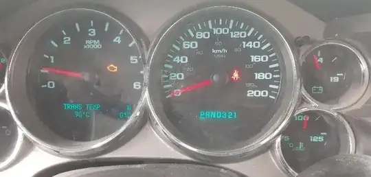

When stuck in traffic or idling, the truck engine stays at 100-105 deg C (good). However, the transmission temperature rises to 90-93 deg C (bad, I think); whereas the normal highway tranny temp is 47 deg C.
Idling:

The engine fans won't turn on to cool the transmission. The transmission fluid is passively cooled in the cooler loop inside the radiator by whatever temp the coolant is at the time. Mind you, this is the coolant temp inside the radiator which will be way cooler than the coolant temps in the engine.
As far as temps for the transmission, at 95° C, you're still in the normal operating range, though getting close to the top. Your transmission shouldn't be in trouble until it's about 120° C or above. If you're worried about how hot it is getting, you may want to get an auxillary transmission cooler for it. They aren't expensive and aren't difficult to install.
As long as your engine isn't overheating, especially in traffic, your fans are most likely kicking on when they are supposed to.
