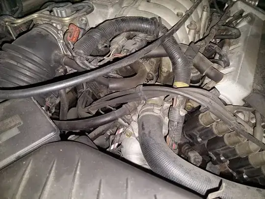

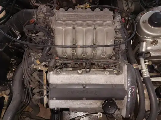

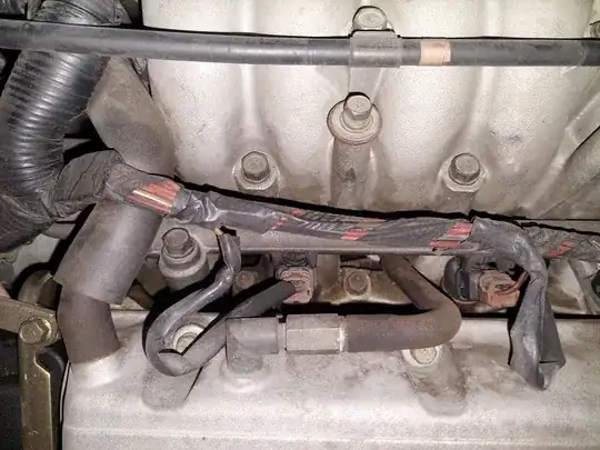

Here are some photos of the engine bay:
View from in Front of the Car
Close Up of Hoses Connected to Front Rocker Cover
View from the Right of the Car

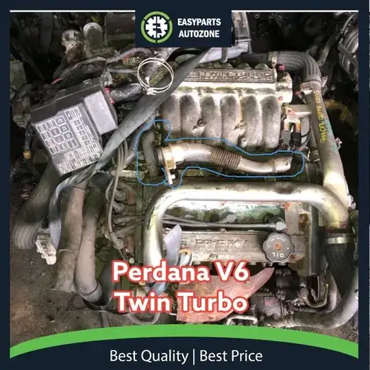

From the sound of it, you understand what a Positive Crankcase Ventilation system is for and, in general, how it works. I don't have a Perdana to look at in person, but this picture looks about right from my research: . Just in case, the PCV valve and visible system is circled(badly)
All PCV's have two things in common: they connect to the intake somewhere behind, as in closer to the engine, the throttle plate and they all connect to one of the valve covers or crank case. If you'd like to read a longer, more detailed explanation of how all this works on a boosted system, click here.
The shortest answer is this: When under boost, either the PCV is completely disabled or vented to the outside. The reason why is that forced aspiration can cause air to flow into the crankcase, creating its own host of problems. So either your system has a cut off, causing the PCV to close while the turbos are active or a bypass that leads to a vent. In the pictures of OEM engine on your vehicle that I've seen, it looks like it simply closes the PCV.

[Edit] Okay, so I would really appreciate input from a more senior mechanic than myself. My theory is this: your system has two PCV/CCV systems. The reason why I believe this is that you have those two ports right night to each other. If one was a vent, it should be on the other end and it would lead to the intake before the throttle plate. Instead, one leads straight down and the other to the intake manifold somewhere. It's hard to tell because there's some sort of control valve around the intake and the hose. You can kinda see the hose loop over and then under again into the intake. Kinda. The other just disappears beneath the engine. You might look into finding the service information for it. I don't know where you are, but here you can go into an Autozone and ask them to look it up for you.
