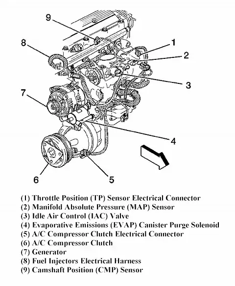

I believe the following diagram should look like your engine:
MAP is at location #2. The MAP will have three wires in the connector. There may be a plastic cover over this area of the engine.
As @FDryer stated, no MAF.
