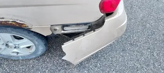

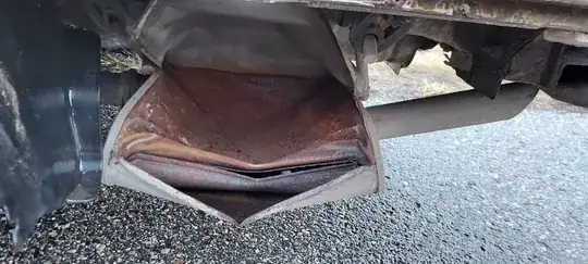

As a completely unrelated issue, the engine has always made a quiet ticking sound when running. I've been told it's nothing to worry about, but I figured putting some SeaFoam engine cleaner in the intake can't hurt. So I did that, and the directions said to apply "spirited acceleration" after using the product. So I got on the freeway and hit the gas, only to hear a loud "bang" sound. I looked back and saw my rear bumper hanging off the car. When I pulled over, it turned out my muffler had exploded and had taken my rear bumper cover with it. I've included photos below:
Torn off bumper
Exploded muffler
Ever since that muffler exploded, The RPMs have been perfectly smooth. No drop off when letting off the accelerator, and no bouncy RPMs at idle. I zip-tied the bumper back on and it's good as new!
Theory
My theory is that my muffler was overly restrictive, which was causing too much back pressure and therefore causing the RPM problems. When I floored the accelerator, it finally put enough exhaust pressure on the restriction to explode it.
