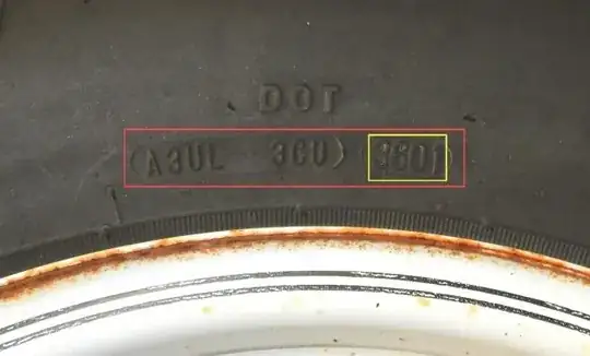

Some tires have a manufacture date stamped on them, such as the agricultural tires shown on this page which is supported by the National Institute of Food and Agriculture.
Tire Safety: Expiration Dates
The fact is that all tires have an expiration date. Surprisingly, many consumers and sellers of tires do not know about tire expiration dates.
Every tire has a birth date—the day it was manufactured—and an expiration date that is six years from that manufacture date.
Expiration dates for tires manufactured before 2000 were based on a 10-year scale because the expected life-span of a tire was 10 years. Current guidance suggests that tires should be expected to last a maximum of only six years.
A tire manufactured-date code, shown in the yellow box, may appear on the outside of some tires. The 11-character DOT code, shown in the red box, appears on the inside of tires.
The last two digits refer to the year the tire was produced, and the first two digits identify the week number within that year ... was manufactured on the 36th week of the year 2001. That tire was on a trailer that had been sitting in a field unused for 10 years, and it showed signs of dry-rot cracking. It is unclear whether trailer tires should be replaced every six years since they do not receive the same daily punishment as automobile tires. However, automobile tires should be replaced every six years.
