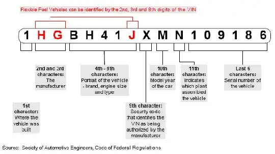

The breakdown of any VIN of a car from 1981 until present sold in North America is as such (from Autocheck website):
VIN decoder gif
This standard is covered under ISO 3833, but there are other competing standards throughout the world. Although, if a vehicle manufacturer wants to sell their vehicle in the United States, they will conform to ISO 3833.
If I find another VIN with the same WMI (5TD) and the same vehicle attributes (DKRFH), but the year and plant code are different, will that always still be the same make and model? (a Toyota Highlander in this example). Are there any exceptions?
For vehicles sold in North America, there should be no exceptions. In most cases the plant code will be the same amongst cars with the same vehicle attributes, because it becomes a lot more expensive for an auto manufacturer to have two plants rolling out the same cars. The logistics involved creates a greater expense for two plants. (It's a lot more economical to add more workers and/or assembly lines at the same plant than it is to run two identical plants.) Some manufacturers do assemble the same vehicles at different plants, such as VW, which does this with the Jetta (Germany and Mexico). The difference here would be, there would be a change in the first letter of the VIN as well as the plant being different.
