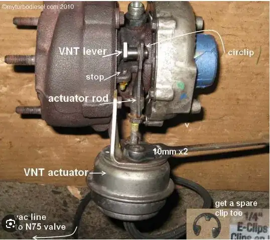

You can do this repair by approaching the turbo from above, through the engine compartment on the passenger side. The engine must be cool so you don't get burned. You need an open-end wrench to fit the VNT lever (see photo below from myturbodiesel.com) and a hand-operated vacuum pump such as a Mityvac, plus a source of light.

Trace the vacuum hose from the VNT actuator can all the way up to the N75 valve on the firewall on the driver's side. Disconnect the vacuum hose from the N75 valve and attach your vacuum pump to the hose.
Pump down the vacuum pump and watch the VNT lever move down. It will move only a short distance, maybe less than 1 cm, and it will not go all the way to the "stop". Release the vacuum and watch the VNT lever move back up.
Your goal is to repeatedly move the VNT lever down with vacuum and back up, helping it move down with gentle force that you apply to the VNT lever using an open end wrench to assist its movement. Down-up-down-up, again and again using vacuum and extra force from your wrench. You might have to do this 20 times or more.
Eventually, if you are successful, you will hear a "ping" and the VNT lever will move down 2-3 cm instead of just 1 cm or less. Continue moving it down-up with vacuum only, to make sure it is now moving freely.
Re-connect the vacuum hose to the N75 valve. The repair is complete.
