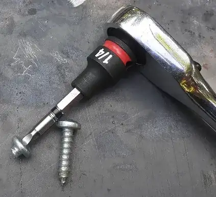

I can fill the holes with a large sheet metal screw. And grind down both ends of the screw to make it flush with the plate.
The side with the pointy ends of the screws:
The side with the heads of the screws:
The screws were oversized for the hole. It took a lot of force to get the screws into the holes.
I tried using a cordless impact driver to insert the screws, but it wasn't powerful enough. So I used a screw bit with a ratchet instead. That worked well for the first screw. But with the second screw, the head of the screw broke off before the screw was fully inserted into the hole.
Note: I would suggest using a socket-to-screw-bit adapter that is magnetic or snaps into place, instead of a regular 1/4" socket that only loosely slides onto the bit. A proper adapter would have prevented the screw bit from falling out of the adapter, which was a nuisance.
