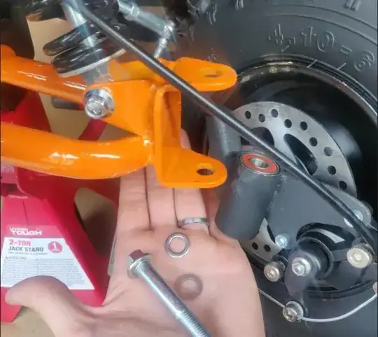

I'm trying to assemble a kids atv for my son. It's a cheap Chinese model with poor documentation.
I can't figure out how the steering knuckle is supposed to attach to the suspension arm.
It was supplied with 2 washers and a nut and bolt. I assume the washers should go between the bearings and the orange bracket, but the gap is not wide enough to fit both (one on top, one on the bottom).
The bearings are pressed into the knuckle, one on the top which is visible, and a matching one on the bottom. I tried tapping them in further with a rubber mallet and they didn't budge.
800W kids atv steering knuckle attachment
It seems like if the parts are assembled any other way, the knuckle will rub directly on the painted surface of the suspension arm.
I could buy thinner washers? But I think this quad was assembled and then disassembled for shipping, so maybe I'm just doing it wrong?

With your description, I'd suggest the washers should act as spacers for between the bearings and the suspension parts. With the internal spacers between the bearings themselves, the washers should provide a little bit of space so the hub won't rub, or will help minimize any rubbing between the suspension and the hub. There are two main reasons why you want this space: hub to suspension wear; binding while turning. You don't want to get larger washers (in the round direction, not in thickness) because then you are defeating the purpose of getting the hub off of the suspension. If you cannot fit the washers in between, I'd suggest you bend the suspension tabs out just enough to enable you to fit the washers in there. As I stated in the comments, using two adjustable (Crescent) wrenches, prying them apart should give you enough extra room.
