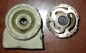

OK, so utilizing information from @MTA about the actual operation of the purge valve, I applied 12 volt DC to it and it operated but never sealed when not energized. This confirmed a bad valve. I took the valve apart, destroying it. In the picture below, you can see the valve base on the left where the valve would seal and on the right, the plunger. You'll note the smooth surface on the right and the darker, rough surface on the left causing it to leak all the time.
I replaced the valve and cleared the codes and the car is back to normal.
