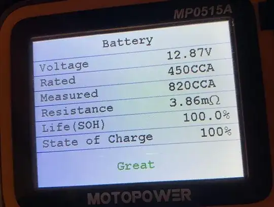

After charging, this is what my battery tester reported:
After charging Honda CRV 2022
The measured amps are now at 820. Not sure if the battery was overcharged.
To answer the original question:
  1. I don't think 762 is too low of a number compared to 820.
  2. I do agree with @Paulster2 on this one that the tick mark measures a low battery and my measured amps was above the rating.
I'm curious what my battery tester would report if I set the rating to 225 as instructed on the battery.
For what it's worth, my Klein multimeter reported a voltage 0.1 Volts greater than the battery tester measured minutes apart. I would be inclined to believe the multimeter was more accurate.
