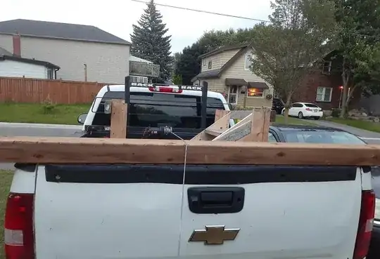

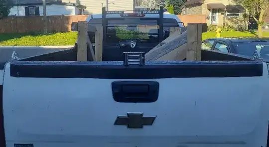

I ended up using two 4" x 4" boards as a brace on top of the truck box/tailgate:
That seems to solve the first problem where the cable was crunching the tailgate. (Although the cable does crunch the wood now, but that's not really a problem.) The boards don't slide back towards the winch because they push against the stake pocket anchors.
If it continues to work after a few uses, then I might try to solve the second problem by installing a fairlead on the face of the rear board to guide the cable straight towards the winch:
  • Drill holes in the middle of the boards.
  • Install the aforementioned fairlead or a thru-deck bushing fairlead (image).
  • Install the cable through the hole: Remove the hook from the winch, feed the cable through the fairlead hole, and re-attach the hook.
Right now, the boards just lie loosely on top of the truck box sides/tailgate. But I could attach hooks that fit into the stake pocket anchors, or attach pieces of wood underneath the boards that fit inside the truck bed, to prevent the boards from moving from side to side. That might be needed when the cable is pointed off at an angle.
The boards will be stored inside the truck box when not in use.

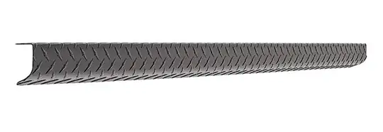

A metal tailgate protector cap might be an option. I could mount the fairleed to the plate. Or just rest the cable directly on the plate.
https://www.mytruckpoint.ca/products/dee-zee-dz2121b-black-tread-tailgate-protector-cap
https://realtruck.com/p/dee-zee-diamond-plate-tailgate-cap/v/chevy/silverado-1500/2010/
