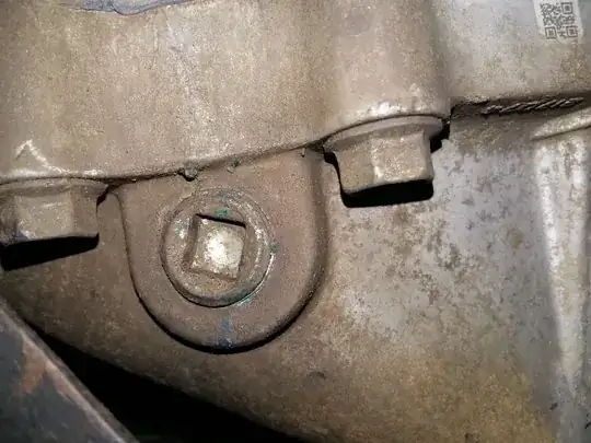

Attaching a few pics from beneath the car, driver side. Does that oozing green paste smeared screw look like it holds antifreeze ?
First pic: I suspect is is the coolant drain screw

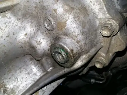

Second pic: More of what the cast iron block looks like; It is about double the size of the oil pan when seen from below.

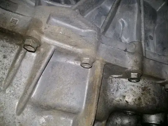

Third pic: Another similar looking screw in the same block, not far away from the first one

I think you're asking, "How can I get 100% of the coolant out of my engine so I can replace it with clean, fresh coolant?" If that's not your question, please stop now and edit your question so that it asks a specific question.
Still with me? OK, good, I'll answer the question that I think you asked.
As in all car maintenance, it's reasonable to simply follow the intentions of the manufacturer. If they did not provide a way to remove 100% of the old coolant from your engine, they must not think that it's necessary.
"Nay, this shall not stand!" you say? You want 100% of the old coolant out, just because? OK, remove the engine from the car, disconnect all hoses and bolt it to a 3-axis motorized engine stand so that it turns it all possible orientations. Switch the stand on rotate in all three planes like a rotomolder for a couple of hours over a spare kiddie pool, and I guarantee that 100% of the coolant will eventually come out of the engine.
Not practical? Hmmm, I agree. Are you willing to settle for almost 100%?
Suppose for the sake of this discussion that your cooling system holds 10 liters of coolant but only 9 liters come out when you drain it according to the manufacturer's intentions. That's a 90% exchange rate.
Simply change your coolant more than once, and run the car under load to full operating temperature between changes. Remember to run the heat when the engine gets hot so the coolant in the heater core gets changed too.
What will be the result? How close can you get to 100%?
e
You can keep going until you don't have a single molecule of old coolant left, just like homeopathic remedies, but only you can decide how far to take it.
But holy cow, you say, this can get expensive! And what about the environmental cost? I agree, but every obsession has its cost. It's up to you to decide what percentage is reasonable. Me, I stop at one change just like most people.
