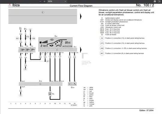

(current flow diagram)
Reading the diagram J126 (fresh air control module) has five wires connected to it (6-slotted terminal), three from the climate control unit (E87/J255) which sends input from the driver and other stuff and then two wires going to ground (53 which leads to ground point 99 in another page) and power (Fuse 36). There's two wires directly going to the fan motor (power/ground) as well shown in the diagram without much detail.
Is the control module supposed to send constant voltage at different speeds to the blower motor or am I misunderstanding how a blower motor control module works? It seems unlikely that both the control module as well as the fan stopped working at the same time.

The blower control module may be using pulse width modulated (PWM) control to the blower - high speed digital switching of 12v power that may not be seen on any multimeter but seen as s 12 volts. PWM switches 12v on/off at high speed to vary the current that controls blower motor speed. An oscilloscope can display high speed signal switching as one way to view pwm signals, seen as a waveform. The simplest way of isolating electronics from blower problems is powering the blower directly from the battery. If the blower does not come up to speed immediately or acts erratically, then it's likely a worn out motor. If you have another 12 volt motor, even a 12v lamp, you can wire it to the connections and see if either motor speed varies or lamp brightness changes. This would verify the control board is operating as designed.
