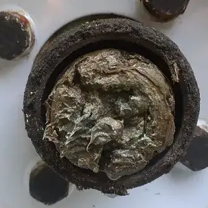

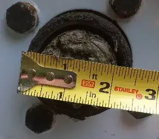

It might be hard to tell from these photos (due to a bad angle/distortion), but the OD of the cap is ~2 inches.
And the OD of the bearing enclosure is ~2.5 inches.
What size of bearing cap do I need? I can't find any 2-inch caps to buy in Canada, so that's why I'm wondering if I'm measuring the right thing or not.
For my notes, water drained out of the bearings when I removed the caps. So it's a good thing I'm doing this maintenance now.
